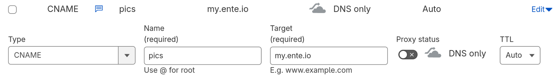

As concrete examples, here is how this step would look for Cloudflare:

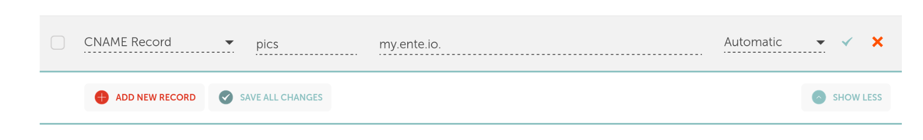

Note that orange proxy option is off. And here is how it would look for Namecheap:

.If you're using Cloudflare DNS, make sure that the "Orange" proxy status toggle is off, and the Proxy status is the "Grey" DNS only.
